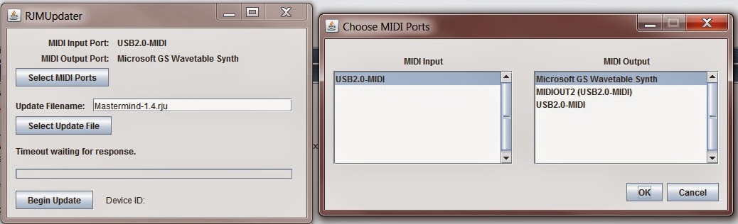

A couple of things to check:
When you start up the updater, does the MIDI interface's name appear in the input and output menus? Also, do you have the interface's output connected to the Mastermind's Remote In, and the interface's input connected to the Mastermind's MIDI Output?

I've tried all three.. Doesn't seem to communicate outwards..
The USB lights up, but midi doesn't seem to..

The output you select should probably be USB2.0-MIDI or maybe MIDIOUT2.
