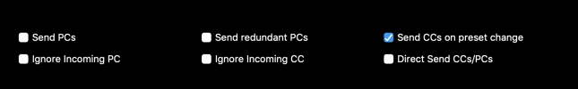

I also just noticed this:
This is on my real settings. On my test settings they both say v4.7.0.
