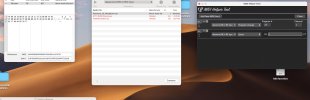

Today was the first that I had the PCB10 and 6 running at the same time. In the Mac Audio MIDI Manager I had to give them different MIDI Device Names otherwise it would have become complicated to control them via Gig Performer. But now to my question: If I am using the Mastermind Editor it seems that only one device can be connected via USB to my Mac. Is that right? I had the problem that when both devices were connected to my Mac and I wanted to send settings to the PCB6 they were send to the PCB10. As if the PCB10 alway had a kind of priority. The only thing that helped was to disconnect the PCB10. Then it was no problem to read, send etc. device settings from the PCB6. One more question: I got the Meris Polymoon. I have a MIDI to EXP Cable which connects the MIDI OUT from the PCB6 to the Exp Input of the Polymoon. I am trying now to send Program Changes from the PCB6 to the Polymoon, but it doesn't work. As far I can see I have the correct settings on the Polymoon. So any ideas which setting has to be adjusted on the PCB6? Bonus question: Is it possible to send not only Program Change, but also MIDI sysex from the PCB6 to the Polymoon? Update: Sending Program Changes from the PCB6 to the Polymoon works now. So my question remains if it is possible to send sysex via the PCB6 to the Polymoon. The screenshot show what I want to send. It is a sysex File for a Polymoon Preset.
