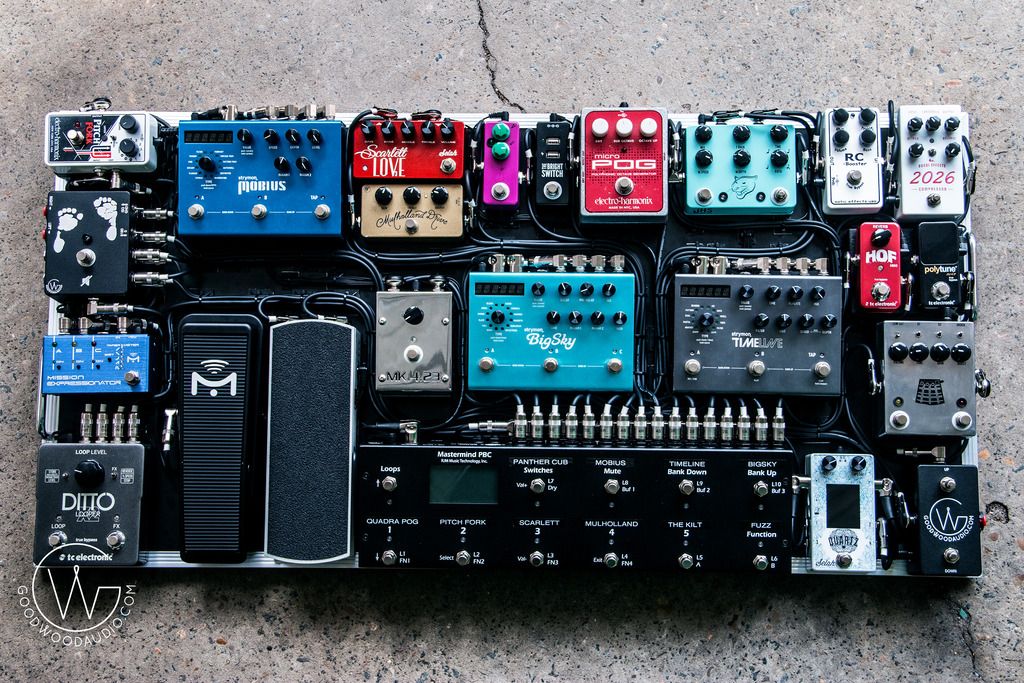

This one was for a client who wanted to set himself up for the foreseeable future without having to change anything. Needless to say, he threw the kitchen sink at it!
Input is the custom box visible bottom right which doubles as an external switch for Page Up/Down on the PBC. It's an active input which feeds the first pedal in the chain and the Poly Tune for constant tuning.
First pedal in the chain is the Xotic RC Booster followed by the soon-to-be-released Bondi Effects 2026 compressor. Both pedals are always on for tone shaping and instrument balancing so it made sense to have them pre-PBC.
Stereo out from the PBC into the Ditto X2 which feeds the output junction (engraved with client's first born's foot prints). The output junction has a Jensen transformer which provides isolation and phase reversal on the right output. This is necessary because the PBC's internal transformer is defeated by the Ditto X2.
The Musicom Expression pedal controls either the Strymon Trinity (via the PBC) or the EHX Pitch Fork though the Expressionator.
