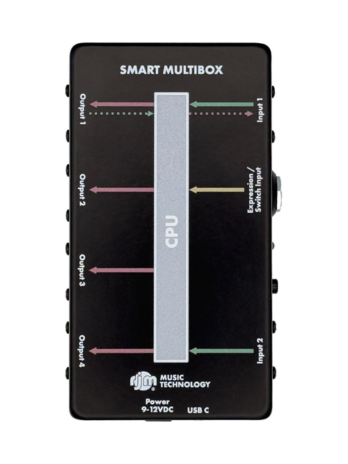

Got something new for you guys. This is a 2 input, 4 output MIDI box with USB-C and a TRS input. It has an ARM CPU that can run Micropython scripts so you can do complicated routing, filtering etc.
Yes, this is a nerdy product, even by our standards.
There's going to be an editor app, which you can use to write your own scripts or download from a database of scripts that we're building online. Also, there are 2 built in hard-coded modes that don't use scripts. In the first mode, the box acts as a MIDI merge and thru. In the other, it acts as a USB-MIDI interface for use with DAWs, etc.
I've thought about doing this for years, but I finally decided it needed to happen. There's just a ton of weird cases that customers have run into, and there haven't been good solutions for them.
More details on the main website: https://www.rjmmusic.com/smart-multibox/
Now available for purchase! https://shop.rjmmusic.com/smart-multibox/
I've thought about doing this for years, but I finally decided it needed to happen. There are just a ton of weird cases that customers have run into, and there haven't been good solutions for them.
I expect we'll be selling them in a week or two. Price is $199
