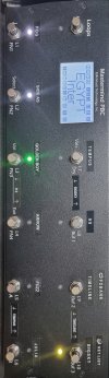

Please take a look at the picture I attached.
As you said, I changed the on color of the hold button to green, but still the same thing happened. So I changed the hold button on color to white again and changed both color to white.
Preset #3 is currently playing, but the hold button is also lit.

Try setting on color to None on the hold function.
I set it up as you said.
The loop assigned to the hold function is now active and the hold LED does not light up when playing the included preset.
But now when I activate the hold function, no lights come on.
