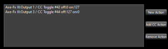

Thanks for coming back to me. So I have attached an image of the way I have programmed this button. Hopefully this will make it clearer. I want this switch to toggle between out 1&3 reagrdless of the state of the preset (ie, the switch on the GT10 tells the axe fx what the output is regardless of preset settings). So as you have suggested, I have ticked 'Send on Preset Change' and 'Update on Preset Change'. The display itself is a toggle - the black half of the screen highlights the active channel. The display toggles just fine, but does not correspond to the output because output is still reflecting what is saved in the preset.
Also, the display for this switch toggles just fine when I hit the button, but given that it is currently taking settings from the Axe fx, its state is not changing realtive to the preset. It just stays where I have left it. I really hope this is clear - Thanks for your help

Hi, Happy new year - sorry for the delayin coming back to you. Correct, I want the Axe Fx to place the output to whatever the setting is on the GT, but all other parameters to come from the AXE FX. I tried what you suggested in your previous recomendation (on 28.12.2022), but I found this does not work. Actually, by doing that I felt like nothing changed at all - Sorry! I must be doing something wrong or must have something set incorrectly elsewhere. Does all of this look correct:

3. Have the following kind of rules applied to the relevant output
Thanks RJM team
